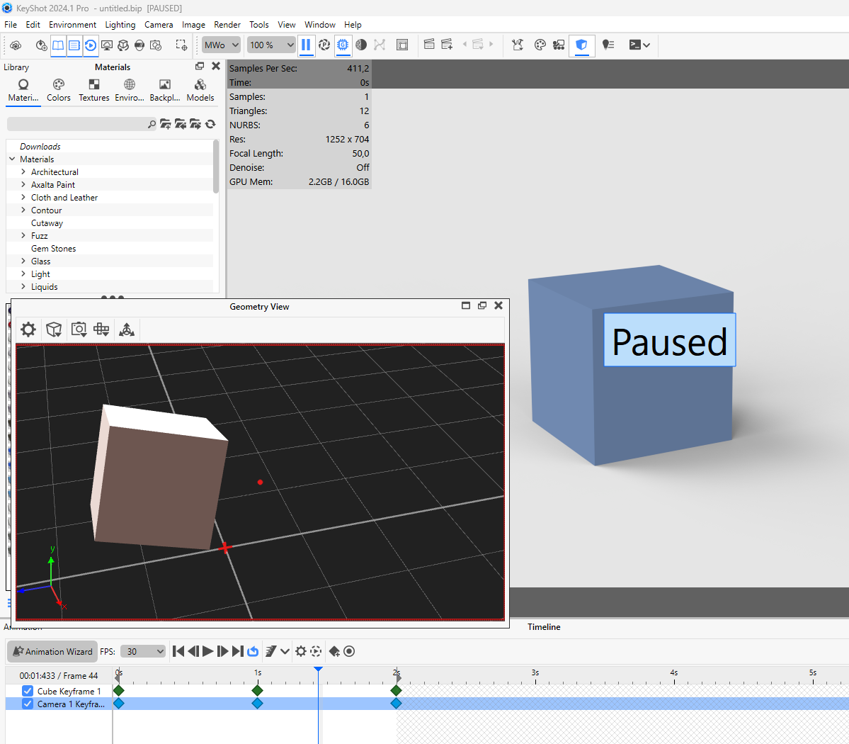

If lighting and also fade animation doesn’t matter, you can pause the realtime rendering and use the geometry view for realtime preview of the animation.
(I used a MatCap in the geometry view, so it won’t show up in the diffuse color)
